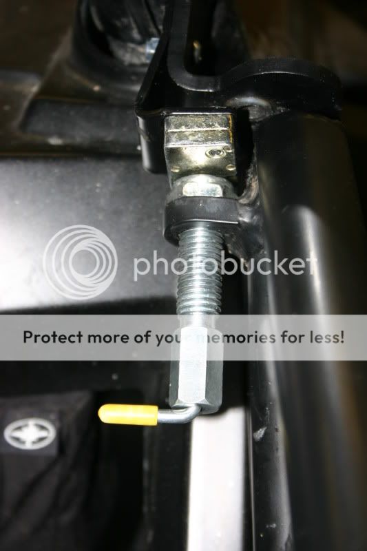

Completed installation / adjustment:

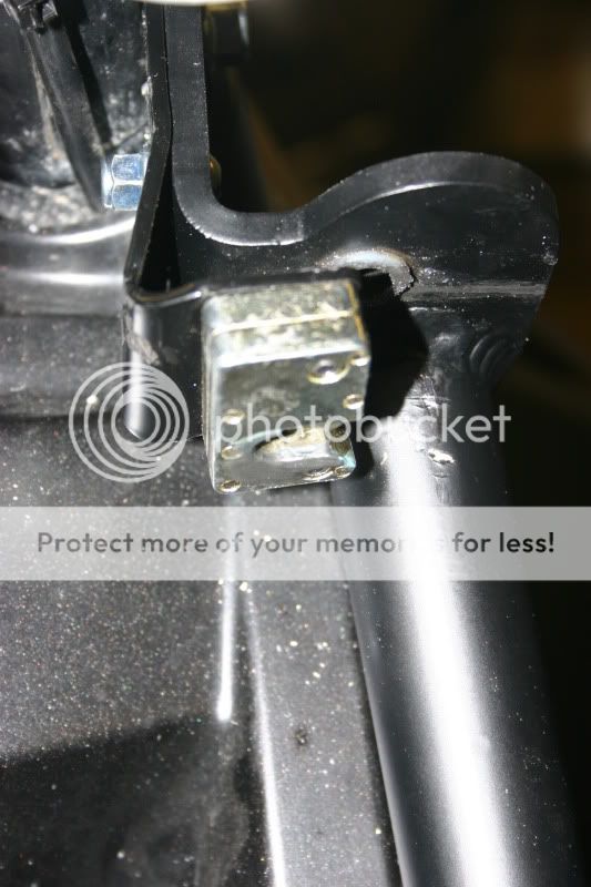

Side view of latch system:

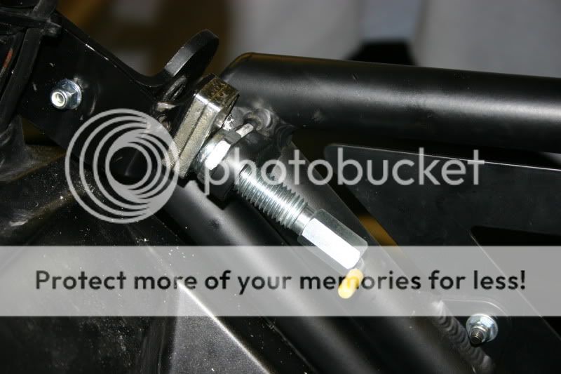

Top view of opened latch system:

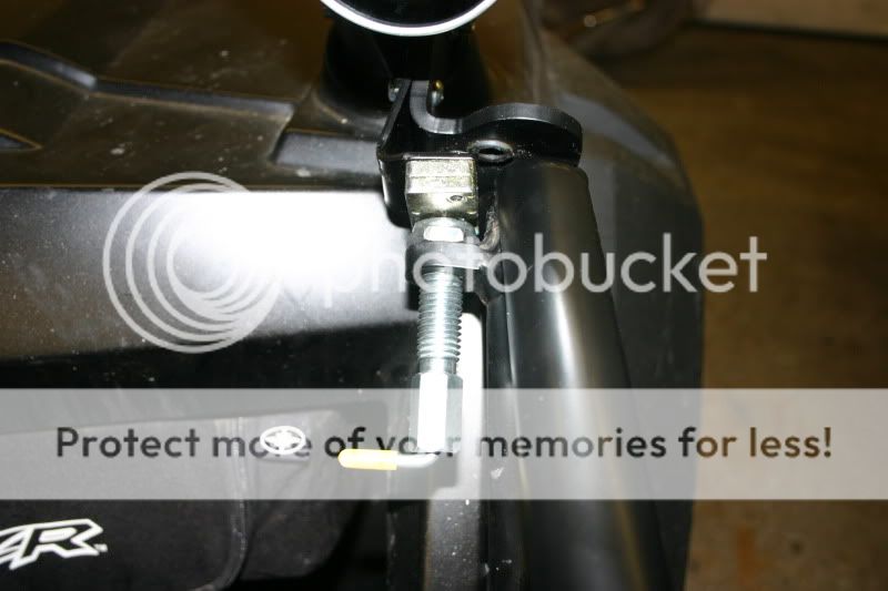

Top view of closed latch system:

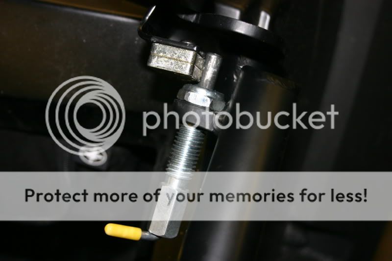

Slam latch mechanism:
