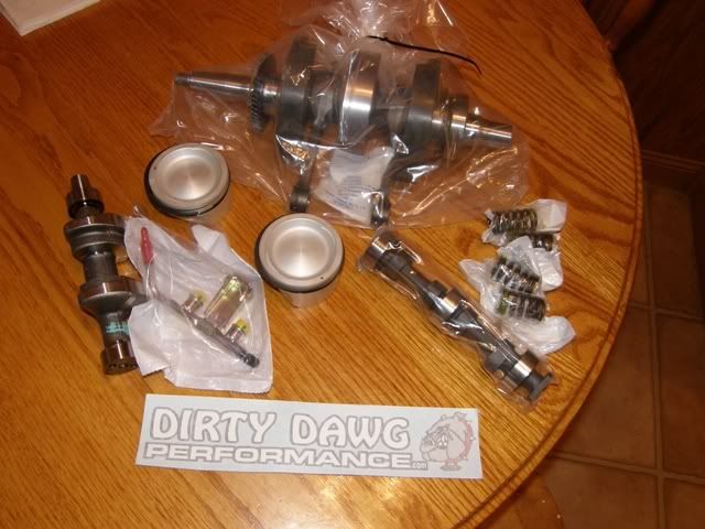

It had less than 5 hours on it when I had enough of the stock 700. I called Dale at Dirty Dawg Performance, and he recomended that I install his 800 kit with his cam, bored throttle body, Boonedocker fuel controller, and a ported 800 head, along with his clutch kit and Supertip clutch weights. That took it from the stock 40 HP to close to 70 HP. It was a big improvement in performance.

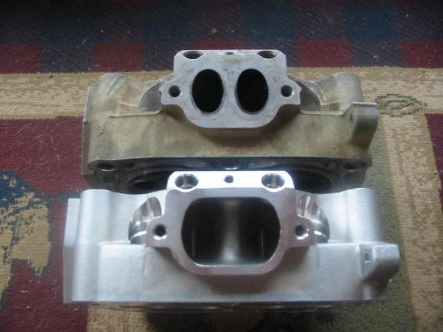

This is a comparison pic of a stock 700 head VS a stock 800 head.

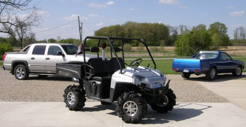

Here it is with the 28" Gorilla Silverbacks that go on when I'm playing in the mud

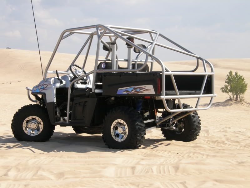

With all the improvements in power and speed it really needed some improvements in handling in the rough stuff, as well as a stronger cage for safety. Andy at Racer Tech designed an impressive 3" over 2" forward set of a arms with progressive springs that allowed my Ranger to fly over the rough stuff, as well as a great looking cage and front bumper.

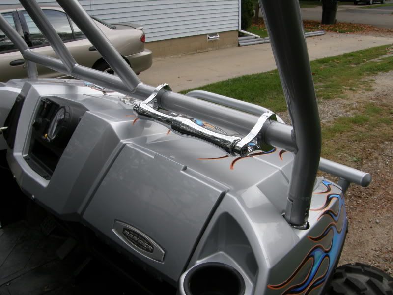

I got a billet mirror, grab handle, hood hinges and flag mount from Super ATV to give it a little bit of shine.
