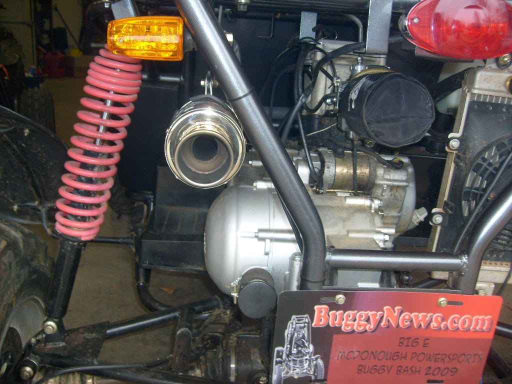

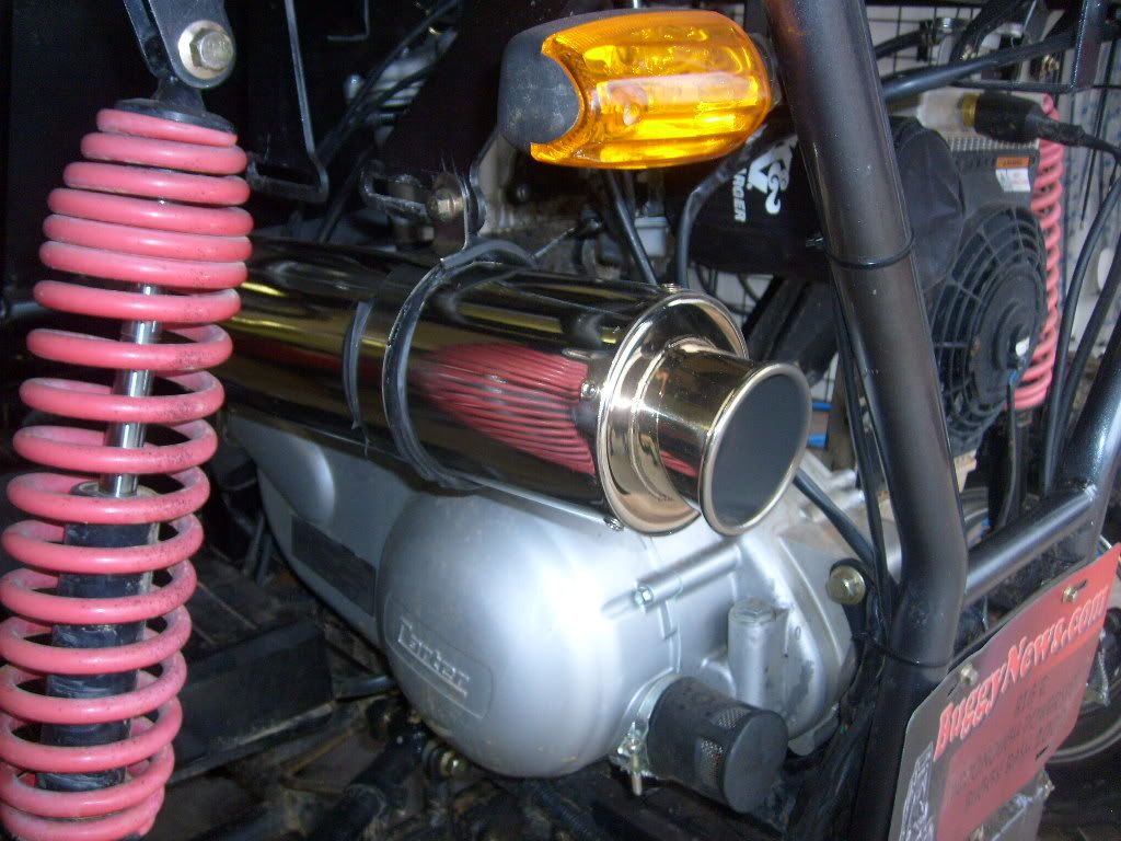

Well I finally found and exhaust that will actually give more power for the Carter gtr. Its a slip on style muffler and staright thru design, with it and a K&N filter, 135 main jet, 35 pilot jet and the clip moved to the secound notch I picked up better throttle response and 3.6 mph.
Still a tad lean on the top end so I will install a 138 main and see how that does.

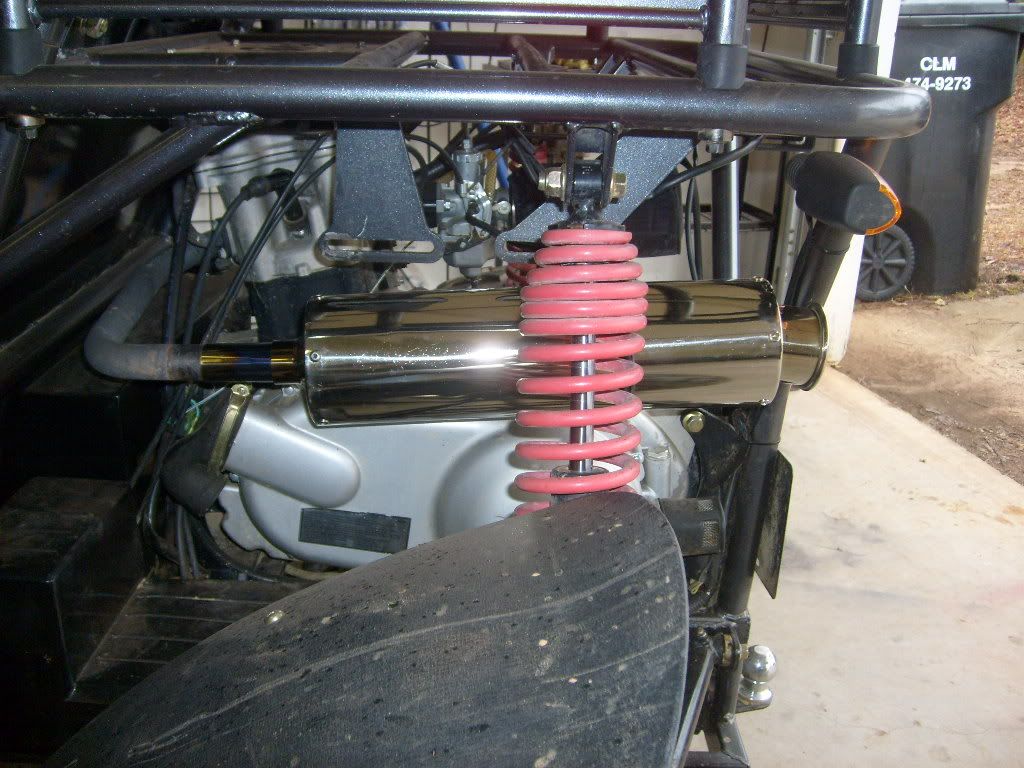

this exhaust is one I imported to try on the carters. there is another exhaust out there but its only bling and doesn't give any real power.
this set up is for a 300cc scooter, the stock header is 1 1/8 outside dia. I have tried 4 different slip on mufflers, this is the only one I have found that's affordable for everyone and showed a real power gain.
