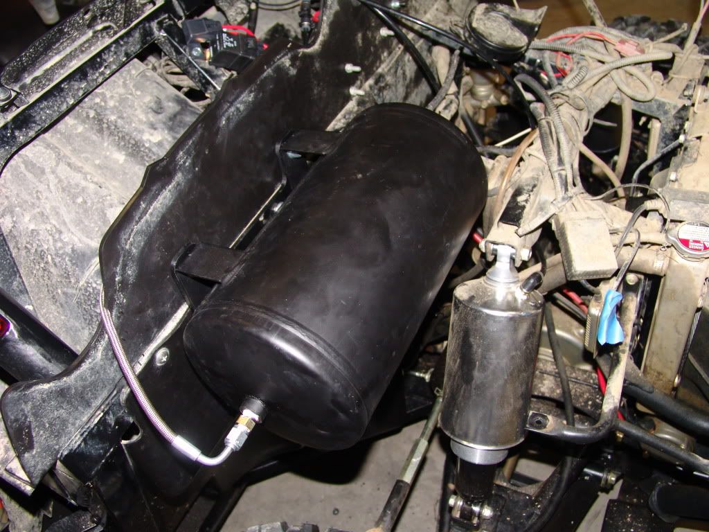

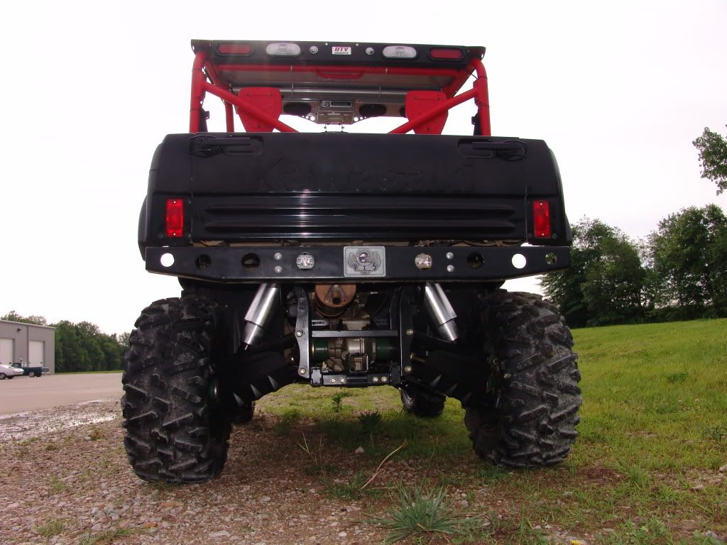

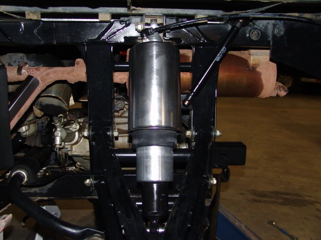

Since I posted up the Rhino, I thought I would go ahead and post up the kit for the Teryx as well. This one is very similar in design to the Rhino kit, where we just do a simple shock swap out. With a couple spacers we are able to adapt the Shockwaves in place of the factory coil over set up. On this unit the owner opted for a simple 2 way control system that uses a switch that valves the air in and out rather than a solenoid valve set up like we did on the Rhino.
2gal tank mounted to the "firewall"

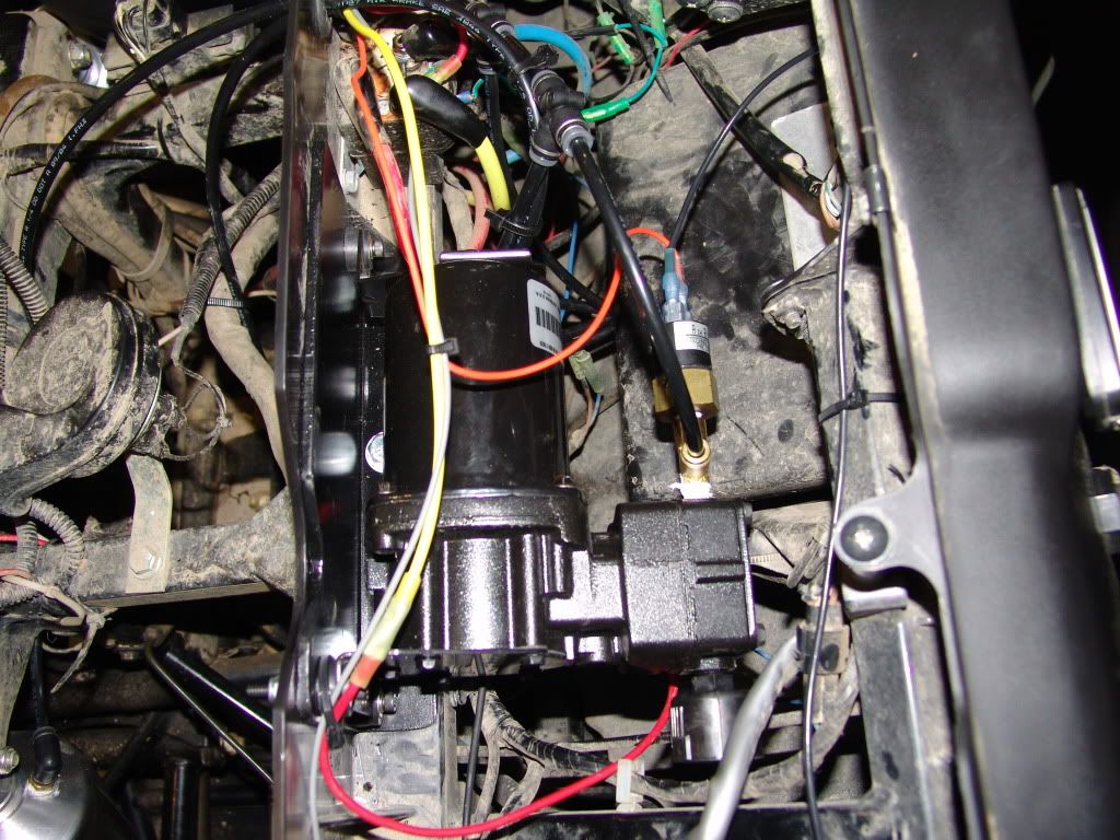

compressor mounted to the backside of the dash
Fully Deflated
Fully Inflated
