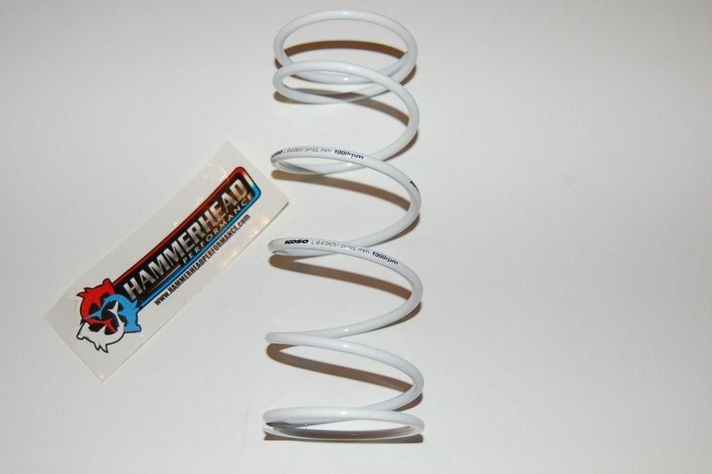

This picture is of a 1500 rpm main spring. A stiffer ( 1500, 2000 rpm )main spring will not move the driven pulley apart ( up shift ) as quick thus keeping the tranny in low gear longer. It also will close ( down shift ) quicker.
